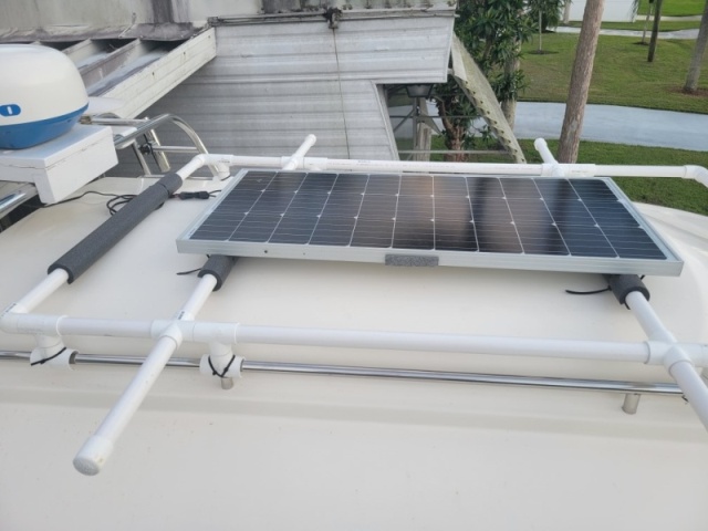

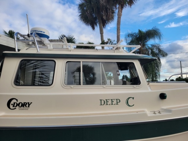

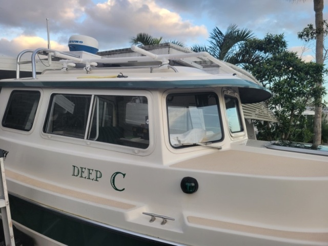

Just fabbed up a PVC roof rack to facilitate mounting the 100 watt solar panel, with capacity to haul an 8' kayak on one side & surfboard on the other.
The rack snaps on to the handrails, already there. No holes were drilled to mount or secure!
I can put it on, or off in a minute, everything is secured with zip ties, and it weighs about 6 lbs.
Just what I needed for extended camping trips & anchoring out in the Keys!
Hope this helps someone with similar needs, cheap & easy! Mike
(unable to upload pics directly to this post, photos are in my Deep C gallery)

Did you reinforce the stubs that stick out? Seems like they could sag in high temps with a load on them. I read of putting electical conduit that fits inside the PVC for rigidity.
real550A
Joined: 14 Jul 2023
Posts: 25
City/Region: Stuart
Vessel Name: Deep C
Photos: Deep C
PostPosted: Mon Nov 27, 2023 5:38 pm    Post subject: Reply with quote
Not yet, but I left the end caps unglued for that very purpose. A one inch wood dowel rod fits perfectly inside, and I have the rods.
