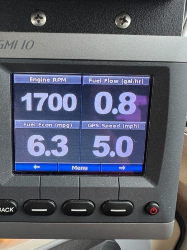

Show us a picture of your helm.
jkidd
Joined: 23 Oct 2006
Posts: 1677
City/Region: Northern, Utah
Vessel Name: Voyager
Photos: Voyager (JK)
PostPosted: Tue Apr 04, 2023 10:10 pm    Post subject: Reply with quote
This is one of my gauges that I can change any of the fields on it to read anything on the NMEA 2000 network. This one can have 10 pages of info.
You can also configure your MFD to display the same info.

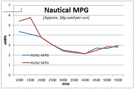

Posts: 21604
PostPosted: Wed Apr 05, 2023 1:19 pm    Post subject: Reply with quote
I have put in flow meters in almost all of my boats. Unfortunately all of their motors were too old to get the information off of the engine's computer.
Foggy gives you excellent advice. You need to know what your fuel flow is at that specific time and on the total of that run. There are so many variables, such has current, wind, tide and seas, which will make a large difference in your MPG or range.
Above is the fuel consumption of "Thataway" the C Dory 25 I last owned. it was made by a previous owner, but I confirmed that it was accurate. At 3000 RPM I was getting about 2.5 nmpg at 8 nautical miles per hour. At 17.5 statute miles per hour & 4500 RPM, I was getting about 3 statute miles per hour.
The numbers posted by serpa4 . seem a little off. I am not sure why, but something is wrong in the way they are being measured? Yes, different 4 stroke engines, different hulls, and conditions; but getting 4.28 mpg at 3000 RPM/& 17.6 miles per hour (I have to assume statute miles, not nautical). Is the boat super light-one person minimal fuel and water etc? The C Dory line are sensitive to weight, as well as windage. Is it possible that current or tail wind etc--or accidental nautical vs statute? How was the mileage measured? Generally with the 200 hp outboards the C Dory 25 gets slightly better mileage than the Venture 26--but it is pretty close.
The other factor is that you are getting 30 mph 4500 RPM, and we don't know your WOT either in RPM or speed. What is the loading of the boat? If these numbers are true--then very light boat, and perfect environmental conditions.
In these boats I have compared the fill up to fill up and they will agree with an average fuel consumption or total fuel used as measured by the flow meter. But it is not easy to get the exact level of fill up with each attempt. The other factor, is the way I boat, it would be a very difficult day to run 50 miles at a constant RPM and constant conditions. I can't think of many places where you can do this.
