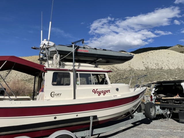

Those look like there made for the stern. Doesn't look like they would rotate far enough to put the dingy on the roof.

Thanks @jkidd what brand and model is yours? Looks great
jkidd
Joined: 23 Oct 2006
Posts: 1674
City/Region: Northern, Utah
Vessel Name: Voyager
Photos: Voyager (JK)
PostPosted: Fri Oct 01, 2021 2:50 pm    Post subject: Reply with quote
https://www.garhauermarine.com/transom-hardware-accessories/lifting-davits/lifting-davit-engine-hoist-ld-6-1-m-long.html

Here is a link to photos of the Garhauer Davit which I have put on 4 C Dorys.

What did you come up with regarding optimum height for your davit? I’m trying to put 2 Hobie revo 13’s on the roof of my 26’ venture and then a 9’ dinghy on top of those.
Tia, CS
Posts: 21504
PostPosted: Sun Oct 10, 2021 2:57 pm    Post subject: Re: Garhauer davit Reply with quote
Catskinner wrote:
Bob,
Tia, CS
I used to own a 13 Revolution, and my current inflatable is a 9.5' air floor with 15" tubes. On our C Dory 25, we added 12" to the base tube. That was enough to get the boat just to the cabin top level--and then slide it up onto the top, with minimal weight on the cabin. I had been thinking about putting the spreader bar lower, and at the point of balance. (it is about 3" off, utilizing the D rings which were already in the boat.
Also we don't know if you are going to use a rack, or just some padding under the kayak directly on the roof structure.
I advise adding 24" for most boats. The problem is I don't know how "tall" Garhauer will make the lower support tube. I also don't know what point you will use to attach the Rev. to the spreader bar.
If Garhauer will allow 30", that is where I would be just eyeballing what is necessary.
Let us know how it works out.
