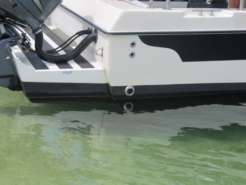

PostPosted: Sun May 29, 2022 10:18 am    Post subject: Reply with quote
Hi Ed,
The aft scuppers are barely above the waterline as mentioned. Each has a fairly stiff one-way rubber flapper valve to prevent waves or wakes from injecting seawater into the cockpit. The downside of this design is that cockpit washdown water can only ‘dribble’ out the flapper while it’s only an inch or so higher than sea level.
The most significant factor on scupper height above the waterline on our boat is the gas load. Twin full 75g tanks carry 900 pounds of gas. A full freshwater tank adds another 230 pounds. Group 31 batteries may avg 70 pounds each. Consider those factors if you haven’t already before moving battery positions, which may produce wiring challenges and detract from inside storage.
Hope this is helpful,
John and Eileen Highsmith
2010 Tom Cat 255, Cat O' Mine
Yamaha F150, LXF150
