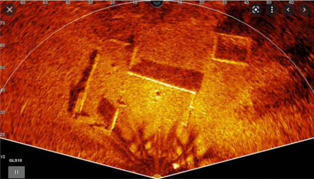

That is a great idea but I do not want that forward facing transducer dragging in the slipstream on a full-time basis. And it is big. (See the photo on Jkidd’s post).

Yes it has a little tiny shear pin, but when I hit the cottonwood under the water it didn't break the shear pin, it pulled all of the screws out of the starboard mount. I also have one of the Livescope transducers that I mounted on a piece of pvc pipe and that clamps to a Ram Ball mount. It allows me to remove it or turn it or just raise it up out of the way. That will also give me the ability to turn the transducer to the Prospective mode and that gives you a 180 deg. image.

Jody, Thanks that is a cool picture. Looks very fun. I am under the impression that I can run the output from both transducers to the back of the Axium and then adjust the display to take what ever info I want from which ever device and put that combination of Data up on my screen. (So, I could have the new, HD screen up and still have the
