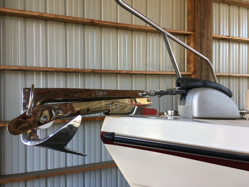

I'm updating my anchor roller (Lewmar pivoting) in advance of installing a Windlass (Lewmar V700 Horizontal on order) and encountered the following issues when placing it consistent with the original (Windline non-pivoting) version:
1: When placing the anchor roller to in the same location as the original, it can only pivot a short distance before hitting the front of the bow as shown in the following photo:
2: If I position the roller forward far enough to allow a full range of the pivot without impacting the bow, it's too far forward - the forward bolt hole will not go through to the anchor locker.
I elevated the anchor roller with a scrap of 1-inch starboard, which looks as if it may work to ensure all the mounting bolts are accessible from the anchor locker and allow full movement of the pivoting section as shown here:
What concerns/considerations should I entertain with this approach?
I assume I may need to elevate the windlass the same amount to ensure the rode remains "level" per Lewmar's installation instructions.
Perhaps I'll get a single piece of starboard large enough to cover the portion of the deck that will include both the windlass and anchor roller, with mounting bolts long enough to be secured from the anchor locker.
Am I missing anything here?
I'm open to other options, since I assume I'll want the roller to be able to pivot for its full range without hitting the nose of the boat.

I have the same roller.
Remove the bolt which connects the pivoting piece to the fixed frame. Slide the pivot forward and use the hole which is just aft of where the bolt is in your photo.

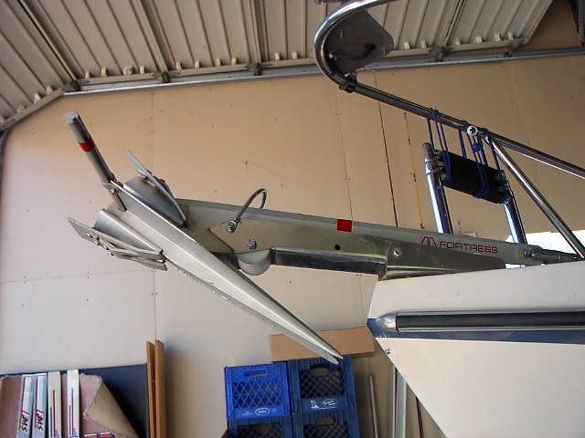

I installed my roller in the same manner that Joe did with Sea Wolf, and there is plenty of clearance between the bow and anchor.
Here is Joe's installation:
Here is mine:
Les - Just moving the pivot to a different existing hole may work with yours.
My roller may not be "level" as Lewmar envisioned, but it works perfectly.
My windlass was already installed before I added the new roller, and there are 3 studs holding the windlass to the deck. I put a 1/4" aluminum plate below the deck. The forward end of the plate is below the roller, and the aft end of the plate catches the forward stud of the windlass. When the anchor chain gets pulled tight as the anchor comes to rest in the roller, the plate helps to absorb the shock.
