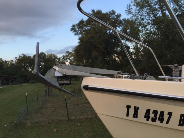

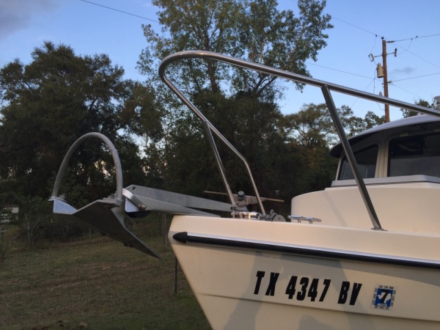

The 13 lb fits fine on the stock anchor roller on my 22. I know it doesn't help much, because odds are your Venture has a different type of roller.
I have never gotten an album here, so I'll see if I can get one and I'll post a picture of it for you.

PostPosted: Fri Nov 06, 2015 10:11 pm    Post subject: Reply with quote
Here are a couple of shots of the anchor.

PostPosted: Sun Nov 08, 2015 9:35 pm    Post subject: Reply with quote
Thanks for the pics...good to see the 13 lb in a roller.
Figuring the 25 lb won't fit in that roller so I'm leaning towards the 13 lbm as you have.
