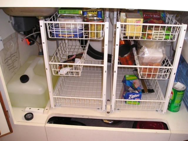

Well, I checked under the counter of my galley, and even though I said above "...I probably could have made it work somehow", I don't see a way to install a cube of 14"x14"x11" (the Bosch 2.5 gallon heater) without major surgery. The only way would be to remove the sliding racks that the previous owner installed (David McKibben -- clever man that he is). The racks are extremely useful, so I would hate to give them up.
All this just means, that in spite of my confusion, I am still glad I installed the hot water recir system. It was relatively cheap, takes little room (hangs from under the counter which was dead space anyway), and gives me a backup freshwater pump should the main pump fail.
