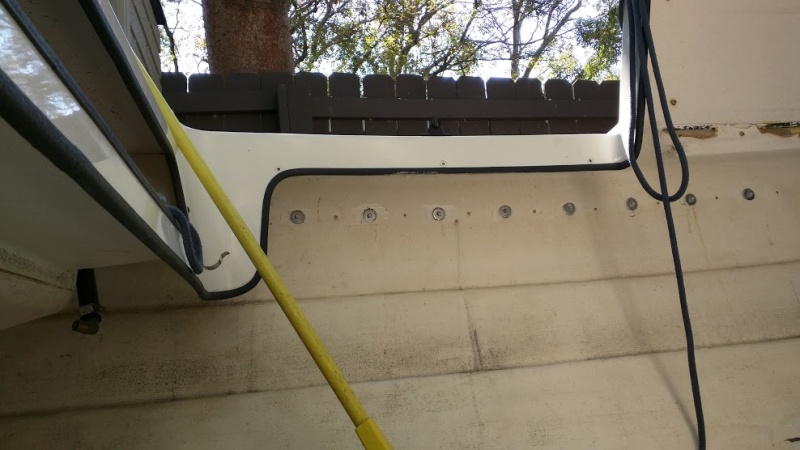

PostPosted: Fri May 13, 2016 3:36 pm    Post subject: Thanks Sunbeam Reply with quote
Thanks Sunbeam
https://drive.google.com/file/d/0B9mqpikgrZBJeWpNOENic1ZIZnM/view?usp=sharing
https://drive.google.com/file/d/0B9mqpikgrZBJcV9jS2ROMTNVUlE/view?usp=sharing
https://drive.google.com/file/d/0B9mqpikgrZBJMEU0UmtjOHVfS3M/view?usp=sharing
Scott Fletcher
PostPosted: Fri May 13, 2016 3:47 pm    Post subject: Reply with quote
Your rubrail job looks great! Thumbs Up

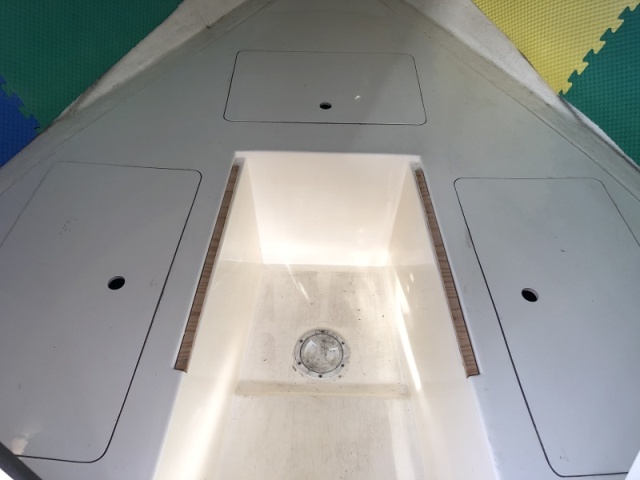

PostPosted: Tue May 28, 2019 3:30 am    Post subject: Reply with quote
Four years ago Sunbeam wrote:
Ever since buying my 22, I've had it in mind that I wanted to cut hatches into the V-berth flat. There were a couple of reasons for this. One is that I just don't like an "inaccessible" area in a boat if I can help it. I like to be able to get to the hull to see things, clean, possibly effect a repair, etc. Two is that I could make use of the additional storage space (keeping in mind that weight in the ends is not advantageous, but I have a number of bulky, light-for-their-size things I could stow there).
For four years I have been looking at Sunbeam's wonderful illustrated essay (starting about 3/4 of the way down page 8 of this thread) on how to cut hatches in the V-berth, hack out the foam, and create an enormous amount of usable space. I will be taking my boat from the Seattle area to Glacier Bay and back (starting May 31) and as I began to pack for the trip I soon realized I had to have more room.
So, with lots and lots of encouragement and even more detailed instructions from Sunbeam, I started my own V-berth project, a few weeks ago.
It took about three full days of sawing, chiseling, hammering, cussing, sanding, vacuuming, and epoxying—but the effort was well worth it. And it really wasn't that hard. Here's what the finished V-berth hatches look like:
More pictures in my photo album, here.
Thanks Sunbeam for persuading me I could do this.
