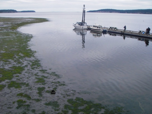

Any chance of positioning something (and getting a look at the sea bed) before you tie up and let the boat go down on the tide. Maybe set a few 4x4's secured to the bottom, or even some old tires might work.
There is a tire in the lower left quadrant here. Been in the same place for years.

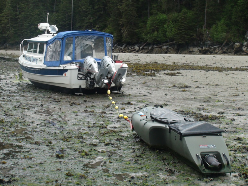

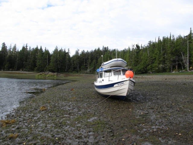

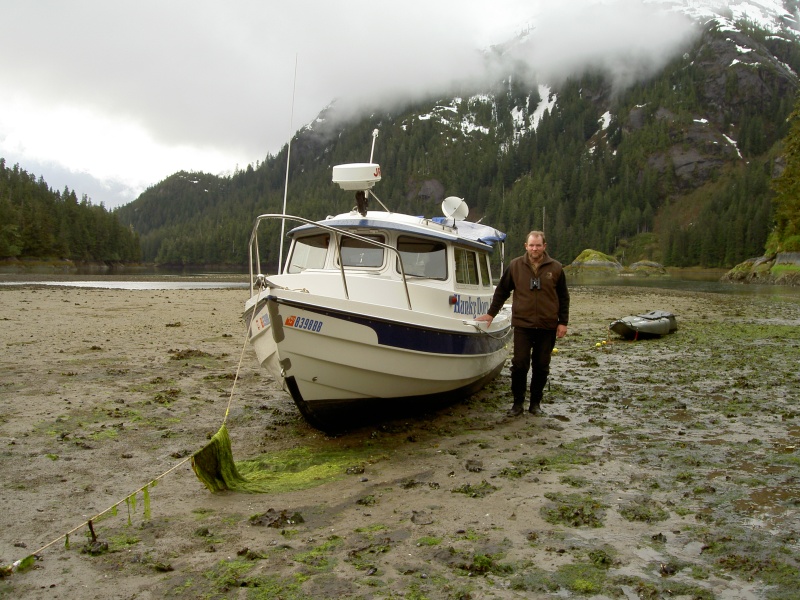

The C-Dory is reknown as a beachable boat with its flat hull and bottom paint molded into the gel coat.
I've since sold the boat but heres a couple of beached pic of mine when I had it:
