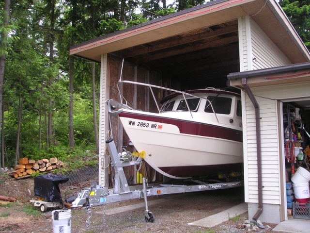

I have decided to purchase a 25, in the near future, but since I live in Alaska, I want to get a new garage built first which will be big enough to keep it in.
Can you all tell me how long, tall and wide the 25 Cruiser is, while still on the trailer? With the twin Honda 90's, tall radar arch (w/average radar on top)? I definitely want to make sure to get the garage and garage door big enough for the future!

Just went out and measured Anna Leigh. She sits on a tandem axle King roller trailer and is 11 ft 6 inches to the top of the Raymarine 2000 radar antenna on top of the tall arch. The width of the trailer is 8 ft 6 inches.
I don't remember if the bunker trailer is higher or lower. I think it sits lower. Also someone else will have to chime in on the EZ Loader.
