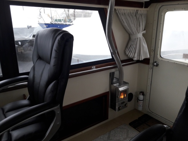

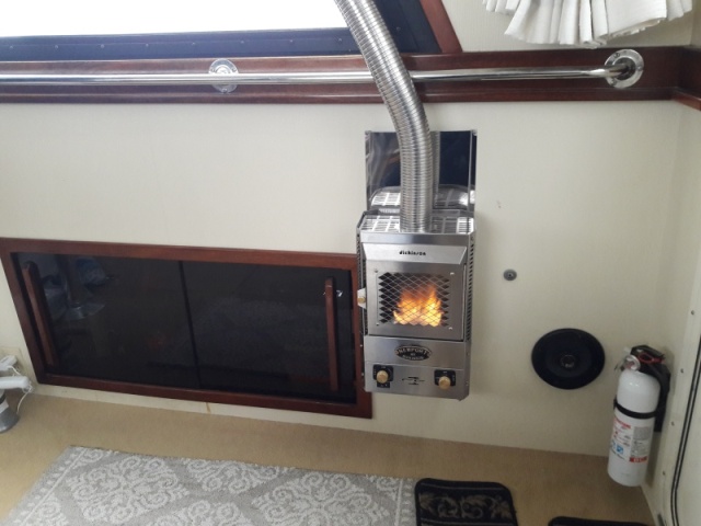

I finally got my Dickinson Newport P12000 heater installed! So excited! My boat already has a dedicated propane system onboard so it seemed like a good marriage. I have a propane locker in the cockpit with the shutoffs, solenoid, lines etc (my galley stove is a Force 10). Also have a hardwired propane sniffer and 2 CO detectors inside the salon.
Anyway, here are a few pics. I'm very happy with it so far. It won't be as effective in heating the boat as a diesel heater but it has another quality which I absolutely love and don't mind trading the loss of BTU's for....It's like having a fireplace on the boat!!! Nice open flame and big viewing window.

Do you have a solenoid valve on the propane tank, coupled with sniffers in the bottom of the bilge, under the propane heater and the galley stove? There should be a solenoid valve that cuts off the propane tank unless you are using it.
A boat like yours is different than a C Dory, and has a bilge where fumes can collect. Open flame, and propane....

The solenoid/shutoffs are brand new and are located in the propane locker (cockpit).
http://dickinsonmarine.com/product/2-appliance-fittings-shut-offs-solenoid/
The propane sniffer (hardwired) display is mounted on the galley floor. I'm not sure if the display unit is the sniffer? I'd be willing to bet that the Camano factory placed the sensor where it would be the most effective...
I'm aware that propane is heavier than air so it could accumulate in the lowest depression (bilge). I feel safe with the install but I understand that burning propane is much more dangerous than diesel.
I'll definitely be monitoring everything. And I probably will never run the Dickinson while I'm sleeping.........

There should be sniffers in the bottom of the bilge, behind the stove, and under the heater. The display or switch module is not the sniffer. You need to verify these. There should be shut off switch in the main cabin...So when you turn off the heater or stove, the solenoid is closed.
The sensor or sniffer elements have a life span of 5 years and should be replaced every 5 years. Hoses from the sealed propane locker, which drains overboard, should be one piece of hose from the connectors in the locker to the appliance--no bulkhead fittings, no "El" or T's. Separate hose for each appliance from the locker.
Unfortunately I have seen all too many boats go "Boom" or burn. Nice to have a fire extinguisher--but what if you have to use it on the stove, or a fire at coupling next to the stove--or if you have to evacuate the boat, if a fire at the stove? My role in all of this had been to treat the burn, or result of trauma due to explosion.

Yes, I have a propane switch in the cabin (well actually it's in the galley). That's the main switch, so I'm assuming that's for the solenoid. The appliances won't work unless that switch is on.
As to the sniffer......I'm sure they are original! So 18 years old. Thanks, I'll look into that. I'll probably just end up buying a couple brand new units instead of refurbing my current one.
As to the appliances: Yes, each appliance has their own line. And the Dickinson appliance line is brand new. But regardless of that there still is a split because I'm running 2 appliances from one 30 lb tank. I'm using the recommended fitting from Dickinson.
