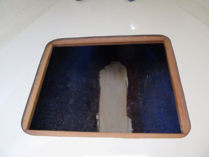

I noticed that the new 25 C Dorys have access hatches under each cushion in the V berth, so I thought that would be a good thing to add. I see that other people have done this successfully in 22s, and 25s. I contacted the C Dory company, and purchased the two aluminum frames from them for about $80. I traced around the frames, and then cut out the pieces with a jig saw, using a metal cutting blade. I then sanded each cut out piece with a palm sander until it fit into the frame. I drilled a large hole in the center of each for easy removal. It gives great access to the large area under the sides of the V berth, and was relatively easy to do. I have posted pictures of the process under Kingfisher, New V berth Access Hatches.

Nice looking job. What sizes are the hatches, and did you use the piece you cut out for the cover?

I did use the cut out pieces for each hatch. The material was thick enough to work well for this. The larger frame is 17" x 17", and the other is 17" x 9".
The smaller one is on the starboard side which is slightly narrower than the port side. Now you can just lift up the cushion, and slide the cover over to get into the storage area. It really works well.

How hard was it to keep a straight line, and match the curves, when sanding the cut-out pieces so that the cut-outs, now hatch covers, fit nicely?

Nothing wrong with the way you did it, but I like the way Sunbeam did her vee-berth hatches. She used wooden cleats that she epoxied to the undersides so the cover piece would drop in flush - no bump from a frame under the cushion.
You can go to Sunbeam's photos in the album named "V-Berth" to see her step-by-step photos.

I found that since the frames had an overlap edge, I didn't need to worry as much about the straight lines, although it was okay. When I traced around the inside of the frames on the berth before cutting, I just cut a little bit outside the line. Then when I sanded the hatch piece, there was a line already there to sand to. I am not sure if that makes sense without seeing the frame.
I agree that the frame does stick up just a bit, but not much. We also have a thin foam pad under our cushions to prevent condensation, so the frame isn't rubbing against the cushion. As for carrying more water, I was thinking that we could carry a water bag on the port side to help balance out our list to starboard, as well as giving us more water on trips. We have a stern water tank, and I don't really like to carry it full because of the added weight to the stern.

My 22 came with the hatches for the v-berth compartments. They are the "flush" hatches, but they still protruded up about 1/4". For some reason, the factory only used the ~12x12" hatches for the side compartments (the forward compartment uses a much bigger hatch). I replaced the hatches for the sides with ones about 20x12". The new hatches are hinged, but I just never screwed them in. It is much easier to use them as slide hatch covers. The new ones don't stick up any higher than the originals and cannot be felt when lying on the berth.
