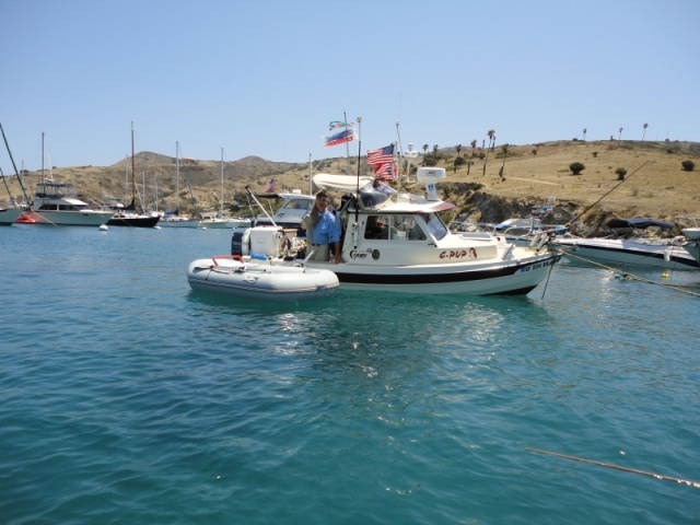

Here is a photo of C pup, at Catalina Island 2012 gathering. He has as much "stuff" on a C D 16 as I have seen. I also saw one which was starting from Seattle area, with the goal of getting to SE Alaska. So these little boats certainly can do a lot more than most 16 foot open boats do.
