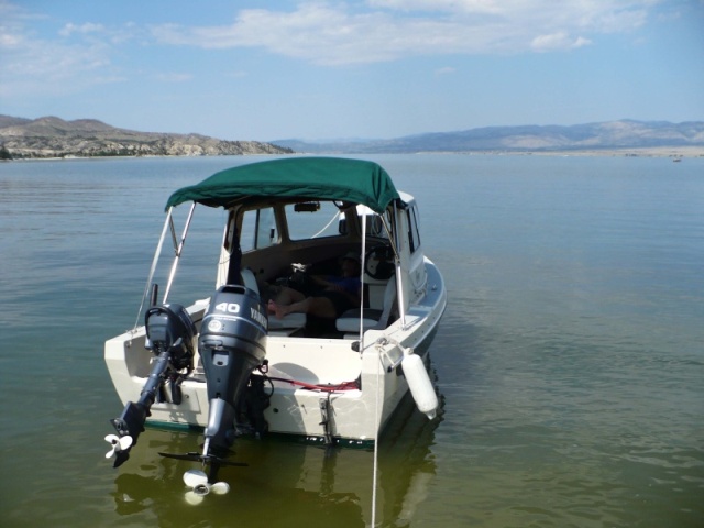

Montana Kev
Joined: 25 May 2007
Posts: 318
City/Region: Bozeman/Yellowstone
State or Province: MT
Vessel Name: Grace
Photos: Grace
PostPosted: Fri May 08, 2015 6:51 pm    Post subject: Reply with quote
Our kicker was mounted on the port side when we bought our 16. I added cutting board material over the fiberglass to keep further scaring of the gel coat. We have a minijacker on the 22 and I would use a minijacker on a 16 if I was doing it today. Having the motor on the port side was fine, you don't need to turn the tiller much on a 16 and we just steered with the wheel using the 40hp as a tiller most of the time. Photos in the album. http://www.c-brats.com/modules.php?set_albumName=C-Loko&op=modload&name=gallery&file=index&include=view_album.php
