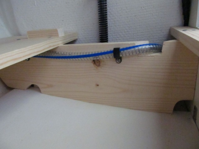

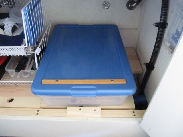

While I was under the galley (literally) doing the rubrail repair, I thought I'd photograph my "four-hour galley stowage" mod. I put this together last year before going to Powell. Basically, the area under the galley was just a big hole, which didn't lend itself to efficient stowage. I was on the road, so had limited access to supplies, tools, and workbenchery. I also didn't know for sure what I wanted. So cheap and easy functioning "mockup" was the order of the day.
To start, I found some inexpensive bins and wire baskets that would fit, and then designed/built a flat platform with stowage underneath. I just used basic pine 1x stock, on which I had the main cuts made at Home Depot where I bought the material. I put it together with deck screws. The whole thing is self-supporting, and it not attached to the boat at all (except a few plumbing hoses are tied into it with P clamps). Yet it is wedged in so it is all 100% tight and doesn't move around. I figured that after using it awhile I would make a better one of finished marine ply, possibly modifying it after some experience using it.

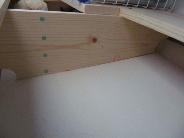

The part I had to customize/cut on my own was the three "floors" that support the bottom platform. There is one right forward, one in the center, and one aft up against the mini-bilge sump that holds the cabin bilge pump on my era boat. I made mockups of cardboard, and then used a jigsaw that I carry with me to cut the same shape out of a 1x board.
After five weeks using it on Powell (with two of us aboard), I'm really happy with it all. Sure, I would prefer more "yacht like" drawers and bins on top of the platform, but not sure I would change anything about the platform itself. Right now the boat is in "storage" mode, so the items in the bins are just various things that ended up there, not how I used it when actually underway. Here is an overview:
The wire bins are held down to the outboard section of the platform with small plastic clips and screws. Two tubs fit on the right side and the top one functions like a drawer. Cleats hold them in place.
The cleat on the lid of the lower tub keeps the upper one from sliding inboard and contacting the locker door.
The upper tub functions as a sort of deep drawer.

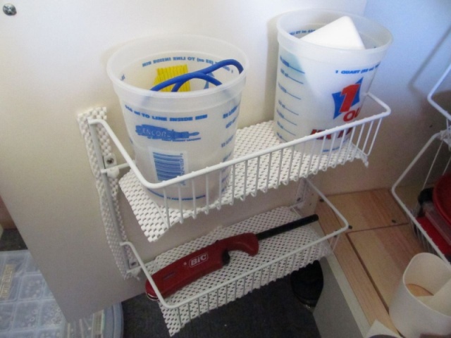

Coated wire storage on door ("quickie" version of teak rack). The scoot guard is because otherwise there is some percussive resonance due to the wire.
After compartment lid partially opened. These are not hinged because I prefer hatch lids that can be slid partially open and/or removed completely.
Forward compartment lid partially opened.

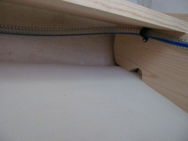

Both lids and after tubs completely removed.

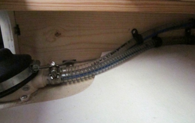

Looking forward under the forward compartment. As a part of re-plumbing I re-routed the hose that leads back to the water tank. Previously it made a big loop and then ran aft alongside the inboard edge of the galley, taking up good stowage space (and making it hard to clean). Now it leads back along the forward side of the galley, then along the hull side outboard, and then from there back to where it exits the galley and runs across to port to the water tank. I also removed the foot pump from the sole and overdrilled/filled the mounting holes withe thickened epoxy, then re-drilled them (along with all of the angles and the holes where P-clamps formerly fastened the water hose to the hull - it now only fastens to "walls" and not into the hull at all).
Water line as it runs aft along the outboard/hull side.
Water line as it runs along the after stowage support, and then over it to meet up with the original hole in the galley base where it goes into the cabin and then across to port.
This is a detail shot of the center support for the platform. The white on the bottom is a layer of shelving foam/padding/liner that I laid on the hull. It is removable for cleaning. You can get a pretty good idea of how the whole thing was put together in this photo.
Moving up, this is a cover I made for the sink - the hole is so that if the faucet drips it goes into the sink. In this photo I have it in a varnish room. I made a similar cover, sans hole, to fit into the square hole where the Wallas used to be. It's been surprisingly handy to be able to remove that when doing various projects under the galley, although ultimately I may replace the whole countertop and likely would not duplicate that hole (unless I fit a stove there). I've found the sink cover handy for other things - if I flip it upside down the cleats that hold it in place make it a sort of fiddled tray. This was just made of a couple of pieces of scrap 1/8" ply epoxied together to make a 1/4" board and then cut out, sanded, and varnished.
