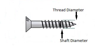

Now I measured the length of the fastener that will extend into the drilled hole so as to ensure the epoxy annulus remains solid and no breach of the core will be re-exposed. Since I have not put any screws in yet, I am wondering how large of a diameter should the hole be to accommodate the fastener without cracking the epoxy but having enough "bite" to hold the fuel filter. Should one drill the hole the diameter of the shaft of the screw allowing the threads to bite into the epoxy or drill a hole slightly less than the thread diameter. The later seems like it would also require some more adhesive to secure (i.e. more epoxy or 5200, 4200). It seems the epoxy is less forgiving than say balsa core would be accepting fasteners. This is where I rely on you folks who have done this before.
I had a book on building plywood/fiberglass boats years ago that gave a list of pilot hole sizes for common screws in fiberglass and wood. It's recommendation was for slightly larger pilot holes in fiberglass than in wood and I found in reality that the fiberglass (an epoxy plug would act the same way) did require a slightly larger hole than wood if one was to avoid the glass cracking. I'd be glad to cite you the book's recommendations but it is long gone.
What I do is eyeball it. Basically I place a drill bit over the screw and select one at least the diameter of the screw shaft for soft wood, maybe 1/64" or 1/32" larger for dense wood like oak or yellow pine. With fiberglass (or an epoxy plug) I select a bit just slightly smaller than the thread diameter. So far that has worked well for me.
