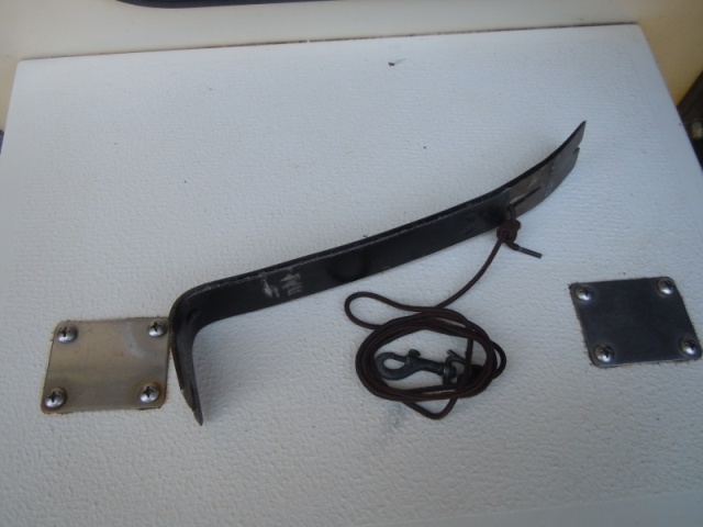

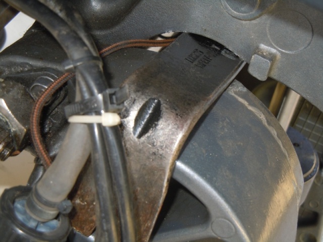

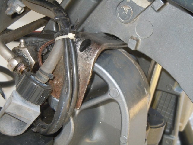

Adding this post here because it was first posted on the "Best Ideas for Under $2)" thread, possibly my mistake.
C-WEED wrote:
I have the Yamaha F80/F100. One day I noticed my lift lock bent out to the point where it slipped off the face and bound on the corner of the bracket. I raised the motor full up and hammered it back straight. That metal is very soft. I have tried dowels, 2x4's, metal all-thread and such and they all fell out dangling on the lanyard in a short distance. In a rush to head to the lake one day I ran to the garage and grabbed what seemed to be made for just this task.
Pics on page 3 of my album. I would post here but don't know how. It is known as a Stanley (brand) tool or Stanley pry-bar. Can be had at any hardware for under $20. Others brands available now. Fits right in perfect ahead of the lift cylinder so it is about impossible to fall out. Recommend lanyard anyway. The leaf spring shape allows the bar to cradle and has a dab of flex so all is well. Works good on my Yamaha not sure with other brands. Longer Bar length is available for larger outboards. Just like it was made for it!
Chris- Here are the photos:
Does the metal bar cut into the metal castings and start corrosion?
