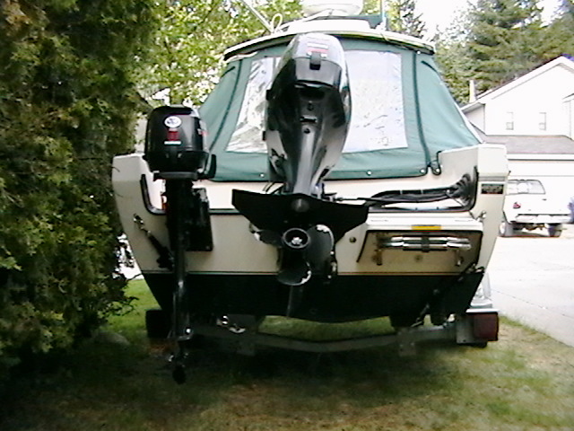

I've got a Suzuki 50HP main & 6HP kicker. I like the Suzuki 6 as it has an internal fuel tank. Honda only offers a 2hp with an internal fuel tank, but nothing bigger. I've had no performance issues with either Honda or Suzuki outboards.
I had a local C-Dory dealer install a Garelek mount for my kicker to keep it clear of the water while underway. Image below.
