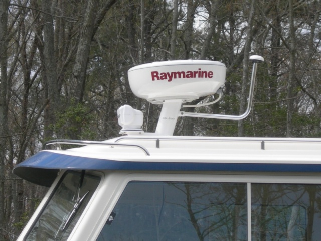

Yeah, me too. I've got the GPS above the Radar on a pedestal with an aluminum mast about 6" from the radome. Have not seen the problem. It's a 4KW Raymarine.

I would say Lowrance/SimRad/et al needs to look at that closely. If a mast that close to the antenna generates that type of target, then there is a high probabilty that a real target to the left or right of the mast would me missed. There has to be some way to blank a one or two degree area of the radar equating to the width of the mast to eliminate that echo. Some installations may not have the ability to move the mast.

I did not try to adjust any settings at all to eliminate the ghosts. My logic in this was that I didn't want to inhibit the definition or sensitivity or limit visibility to any area even aft, if the ghosts were caused by an external mast or other target. I know that some masts, etc cannot be moved and that other solutions would have to be found. I assume there would be alternatives in this case.

Interesting--since conventional wave guide radar would not have caused that interference--even aluminum masts don't on sailboats.
What I am concerned about in your set up, is that it looks as if the GPS antenna is both in the beam of the radar--and is being shadowed by the radar dome--the dome itself is not an issue, but the metal part of the rotating bar is. Lowrance (Navico?) products are very susceptable to radar waves, and many of them have burned out the antennas. I am not sure if Simrad is using the same antenna--but it is very possible. If the antenna is within several feet of the radar, or within a 30 degree beam of the radar, I would move it.
