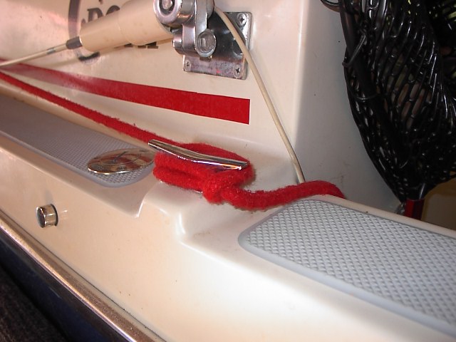

I added a cleat on a raised area just forward of the beginning of the bulkhead and the cabin corner to get another cleat where it was somewhat out of the way, and would also serve to tie another fender, although I didn't pick it for style match so much, and optened for more modern, flatter cleat to keep it down, out of the way a bit more.
Later boats do not have this larger flat spot, I think, intended to keep the run-off and splash water out of the cockpit. This is a smaller, 4-inch cleat, as compared to the 6-inch gunnel cleats, and the 8-inch bow cleat.
It also works great to tie the double-sided bow line that I keep running down both sides of the boat to be handy when needed. This line must be kept short enough that, if dropped overboard accidentally, it can't reach and foul itself in the prop.

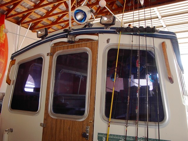

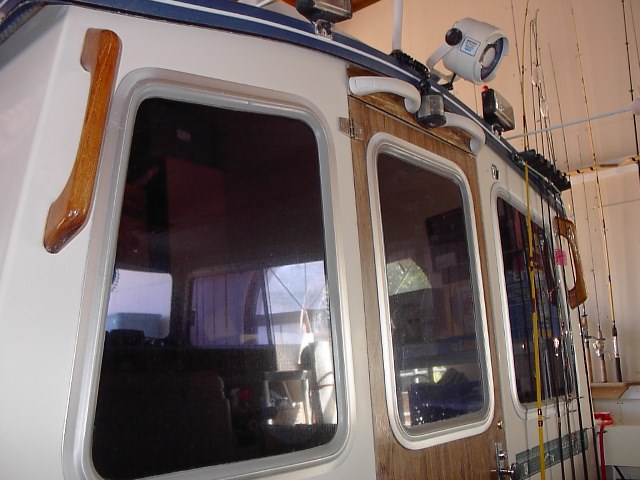

The choice of handles is yours, just pick one that fits your hand and looks good to you. I like the teak wood ones, which I have on the boat, but they have to be kept up. I did mine with 9 coats of polyurethane in '92, and they still look good. Different style handles look better or worse in different positions and for different uses, too. Stainless, Wood, Plastic, Brass--lots of choices.
Here's another handle idea: I put two shorter plastic handles above the door to assist on stepping down from the gunnels into the floor, which can be a big step for us as we get older.
I use a Cosco plastic step stool in the corner near the bulkhead and gunnel junction corner to reduce the big step down into two more equal smaller steps. The handles give you something in the right direction and height to help you hold on to as you step down into the cockpit floor.
Great to hold onto in heavy weather when standing in the cockpit, too. Up there, they don't interfere with the door operation, either.
Some of these placement issues are very ergonomic, and you have to try them out to be sure they fit you, or to even understand how good they really are, which you can' t truly appreciate, until you do!

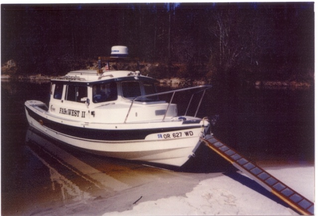

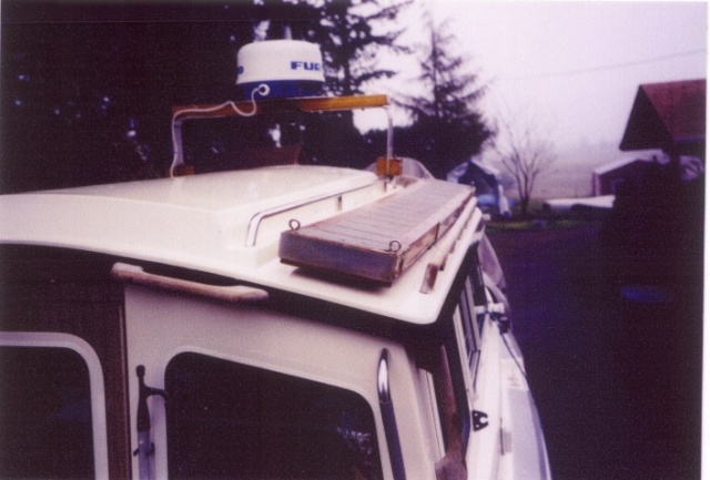

More ideas and photos-Yellowstone John's Far West II:
Handles, Handles, and More Handles! Handles everywhere!
Better than falling down on your arse or going for an unscheduled swim with Mother Nature, eh, Jim?
