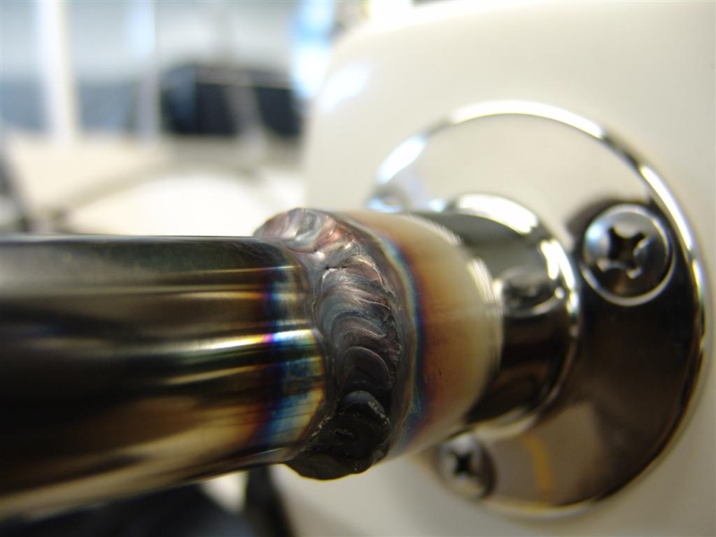

I'm working on a rail project and am looking for an easy way to make the welds look like the ones on the bow rail. I can polish the discoloration on the flat surfaces easily but, the weld takes much more work. The project will have a total of 18 welds, 6 base welds and 12 tee welds. What kind of buffing wheel or compound should I use?

You have a good hand... your welds look really professional...mine look like chewing gum...
What I did was buy a small 1" band sander from Harbor Freight (cheep one) and a mondo buffing machine (also cheep Harbor Freight) ... I sand the weld as smooth as I can...then buff the daylights out of it...using a rough compound then their stainless compound...that makes it look really nice... not as nice as factory welds but very acceptable.. I think that buffing machine was under a hundred...and the hand held belt sander something like $30....

I'd use a STAINLESS wire buffing wheel and it you really want a nice job buff them with white buffing compound and a buffing pad.

Thanks for the compliment. I'm quite familiar with Harbor Freight tools. That weld was done with their TIG welder. I bought it just for this. I'll take a look at what they got.

Use less heat & less fill. ( full-penn not required Wink )
I would get out the flapper wheel with 220-320grit & clean thoes up. Then polish with a felt bob & finer & finer compound till you get where you like it ! Mr. Green Beer

I guess this is a base/mount weld. Difficult due to the different mass in each donor. I would have turned the mount down so there was better heat transfer.
Now that it's joined I guess you can't put it on a lathe.
I would run the tip around again to pretty it up.
Or run the tip on the fat part to take the edge off and re-flow the existing weld.
Then a stainless brush with some compoud
