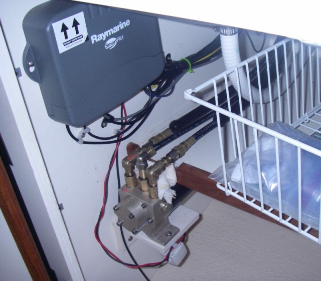

I also read one of the former threads were in someone said "the s1000 pump noise is like a mini jack hammer" and that really scared me too, almost enough to think about putting mine out back in the cockpit. But now that I've got mine running I don't think its all that noisy and I'm sure glad I did not do that.
Mine is mounted directly under the hydraulic steering helm on the back wall of the v-berth cabin. I mounted mine horizontally, but vertically might be a tad easier because its easier to see the little screw you have to turn back and forth for bleeding.

PostPosted: Fri Sep 26, 2008 7:55 pm    Post subject: Reply with quote
Picture: old 87 22 angler. Actually horizontal, but one screw needs tightening. Item up top is fishfinder module.
