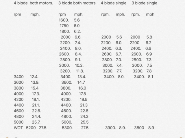

PostPosted: Sat Sep 14, 2019 11:55 pm    Post subject: Reply with quote
The is the rpm = speed data running 13 pitch 10.5 inch diameter 4 blade Honda aluminum & 14 pitch 11.1 inch diameter props on Yellowstone Lake where the 120 hp twin Honda 60’s put out 92 hp.
I prefer to save motor hours by running a single at between 2100 rpm & 2700 rpm getting 6 to 7 mph at displacement speeds, then running up hours on both motors to get the same speed running them between 1750 rpm & 2100 rpm. I think the fuel economy will be somewhat better at displacement speed on a single also, but haven’t ran both ways long enough while keeping exact track of fuel usage to say for sure.
