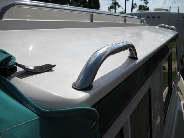

And/or others who may have installed same. I'd like some background before starting. Bob, yours appear mounted so the after leg at least may be through bolted inside the cabin. Were you concerned about the strength of the laminate farther forward on the "visor"? I find some rails with threaded bases (much less expensive: "Seachoice" so maybe "Chinese stainless"?) and some with studs but can't see much to prefer in either style. The whole area being more or less curved I expect difficulty finding an area where the bases will lie relatively flat. Just hoping for hints before buying and drilling.

We had forward grab handles installed on our boat before we took dely. IIRC they're bolted thru the "eyebrow" over the windshield, I just looked at interior pix & don't see any bolt heads up fwd. You can see them in the first pic in our "Knot-Home" album http://www.c-brats.com/modules.php?set_albumName=Knot-Home&op=modload&name=gallery&file=index&include=view_album.php
They make for a safe feeling when going fwd if there's any motion of the boat.

In some of the shots in my album you can see forward and side hand holds installed at the factory. Very strong and have saved me from a few awkward moments!! Also have interior hand holds which I would not do without.

Here is the photo of the C Dory 25's hand railings. The near one is on the outside of the cabin top, under the lip, all of the way aft. The far railing, on the 45 degree bias, is all of the way foreward. The outboard stud (1/4") is like the aft railing, between the cabin side wall and lip of the top. The inner and foreward stud, is through the top eyebrow, and the forward cabin house. Both holes, washers and nuts are outside of the cabin. The trick is getting the hole right in the center between the cabin house and the lip--then getting a washer and nut threaded on the stud. I used museum putty to hold the washer and nut on my finger tip and start it on the stud. After started, then I used a socket on a universal joint to tighten the nut.
I have used these railings on the 22, the 25 and the tom Cat--they have been plenty sturdy to hold my 200 lbs. We avoid going foreward in really rough seas, and have a windlass on the CD 25 and Tom Cat. I have long enough arms that I can reach from the hand hold on the cabin top to the bow railing--but I cannot swear that I could do this hanging on to the top and then the railing at the same time. It is one motion, and I don't feel insecure. I had not considered a hand rail on the lower trunk cabin, since I felt that might be in the way, and I could trip on it--but for some it may be an excellent idea. Certainly a lifeline could be rigged if necessary very easily bewteen any of the hand rails and bow pulpit railing.
