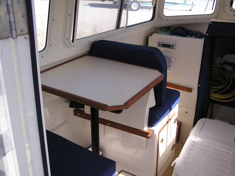

Here is a detail shot from another 2007 C-Dory (I think attachments have varied over the years). If this was the style of yours, I would think you would have this wooden "slot" piece on the seat box. Then it would be a matter of .... do you have the fiberglass molded "shape" that fits into it to support the back cushion? Maybe it's something you were wondering about the function of?!
(Or maybe yours works differently altogether).
This is from a 2007 named "Skeeter" that was for sale at one point in time.

I have that wooden bar with slots but not the fiberglass insert.
I suppose I could fashion a wood replacement - if I had even the barest minimum of carpentry skills, which if course I don't.
Does anyone know of a source for these or similar seatbacks?

Apparently the methods of reversing the seat are endless! While looking through my boat for something else, I came upon this "cutting board" contraption and it all came back to me.
On my boat, you insert the "cutting board" in a slot in the folded leaf of the table and then into the wood frame on the back of the seat.
The trick then is securing the cushion - and I just couldn't figure out how to do it until some foggy neuron lit up and I remembered finding an ADDITIONAL cushion on the boat. Sure enough, I found the extra seatback cushion in the v berth and it has straps with snaps to fit around the leaf and secure the cushion.
The cutting board takes up almost no storage space (I had it behind the water tank) and, in a pinch, could be used to slice vegetables!

Just following this thread a bit. I have a 2007 and it uses the plastic insert for the reversible seat. Seems to me the hinged table would work better. The plastic does not provide much support and I imagine would break fairly easy if one were to lean back much. I have reversed the seat twice, but tend to leave it in the forward position. The table somewhat supports it from bending backwards, but when in the facing rearward position, there is nothing behind it helping to brace it.
